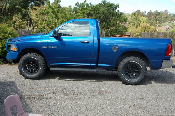

The only criticism I have, and it's a minor one, is that they ride a bit firm. But when I air down to 33 psi cold, they ride ok. Be careful driving thru wet grass. You'll leave a trench. Don't ask...
