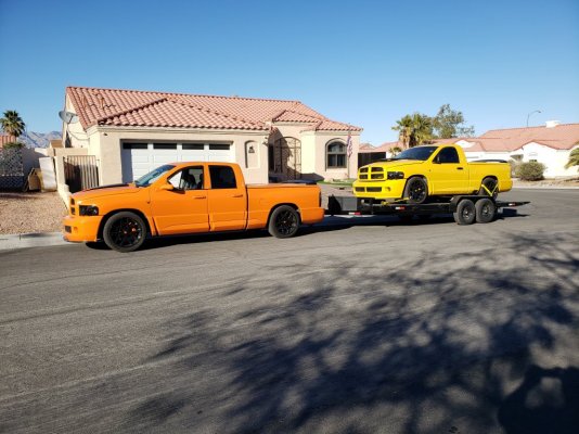

As long as exhaust gas temp settles anything can tow, its everything else you have to worry about - tongue weight, wdh, trailer axle ratings (including the trailer weight), rear helper bags on truck, brakes on trailer, breakaway brakes for trailer
