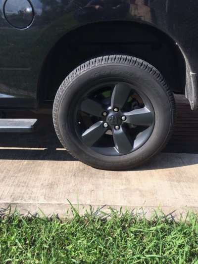

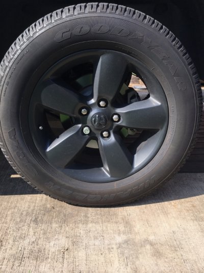

jdavila99999
Aug 31, 2017
310
83
Stock rims 6c2e983164805d3b3c8a7a06030644ff.jpg8ec11d8045a99ac3d20776125e92c4e9.jpg

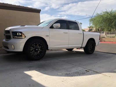

My 2015 stocks are 20x8. It's all about offset. I have a 37 on a 4" lift stock wheels. You can run close a tall tire around 34 to 34.5 stock height. Each truck is different, what fits on one might rub a little on yours.
