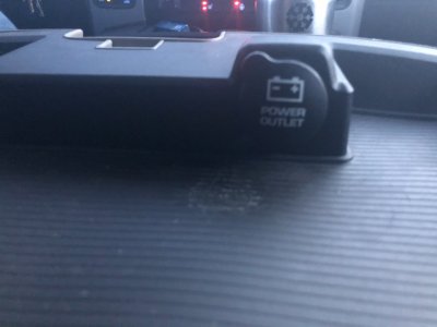

Hi all, sorry this was me. I just bought the truck about 3 weeks ago with 9K miles on it. Window sticker attached shows this came with a center console from the factory and USB hub.
Its weird. There is no Aux input, no USB charge, and no USB port in the center console. Only a cig power plug. I pulled the rear vents off of the console but did not see the wiring installed for the hub. The Uconnect 8.4 head unit shows USB and Aux as options on the screen as well.
I put a call into the dealer to see whats up since they advertised the truck as containing USB and Aux (and some other things it didn't come with) and am waiting to hear back what they'll do for me.
1DF57D10-07B3-4732-B344-C4EA686D3097.jpeg A33044A0-C8BF-4707-85CE-0CA8CCFA519A.jpeg E288A3C0-1169-42C5-82C4-CE0772CC4429.jpeg

Oops, sorry about that, wasn't paying attention. Your console doesn't look very deep. I want to say mine is a couple of inches deep (2"-3"?).

UPDATE
Went and talked to the dealer. Their hypothesis is that since they used this truck as a loaner for a few months, a customer removed the original center console and swapped theirs. That actually makes sense to me.
Now we wait to see if they are willing to help me out on this.

They’re going to swap out the console for me so all will be good.
