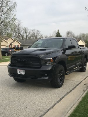

5941B4BE-316D-468E-B559-2775B63219A0.jpeg 36986305-54B8-48D8-BF72-3C6CA16B1A10.jpeg I have Zone UCA’s and Bilsteins set to 2.8. I also have the Icon rear 1.5” and it has about a 1” lean after it all settled. Looks pretty level when I towed a trailer.

Thanks

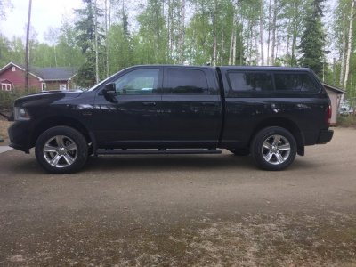

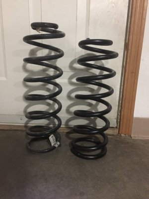

Well I finally got it all done over the weekend. Installed new Bil 5100's in the rear along with Tuftruck 1211 springs and the Core 4x4 lower control arms. The rear install went pretty well as I also bought the Thuren rear shock nut set which made the upper rear shock nut a piece of cake to remove and install. I should mention that their kit includes nylock nuts, but I didn't use them since most of the nylock material is destroyed during the welding process. One thing that did surprise me was how much shorter the 1211 springs are. I mean I knew they were going to be shorter than OEM, but man they were almost a solid 2" shorter than stock. I also kind of expected them to raise the rear up more to a normal unloaded ride height since my shell is around 180 lbs. I think the new springs netted me around 1/8" of lift depending on how you wanted to look at the tape. Thought I read elsewhere on the forums that folks were getting closer to 1/2" of lift when compared to the stock springs with a shell.
I did install the front 5100's to the 2.1" setting since I had purchased the Zone UCA's too (just before they jacked the price to $499 lol). The UCA's may be overkill for my setup since I'm not a off roader, but we do have plenty of scarcely maintained and unmaintained gravel roads with large potholes that can sneak up on you. Still need to get the alignment done and now have some noticeable positive camber. Hope the shop doesn't have any issues with the alignment. They are experienced with lift installs so theoretically they should know what to do as many members seem to have this exact combination.
I'm happy with the new set up as it does feel firmer than stock and actually tracks well considering no alignment. In the end the truck is damn near level. Passenger side front turned out a 1/4' higher than the rear and the driver side front is 1/4" lower than the rear. I did end up ordering a 3/4" TGC poly spacer to get a bit of rake back for towing.

Looks good, nice work
You changed the lower control arms too?....got a link?
