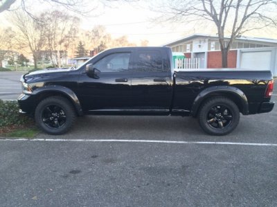

Bils 2.1 35s no spacers here. I would say yes to spacers with a lift. I only have about a half inch clearance right now.
