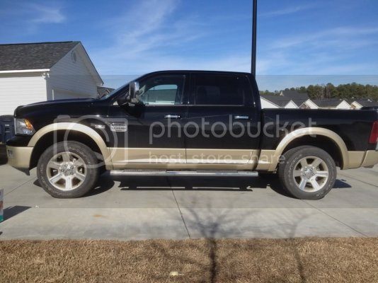

-4706-4BCB-A234-38CFA325A4A4-1572-000001C45801405A.jpg heres mine set at 2.8 it settled some on mine or my eyes are tricking me cause i hate any kind of rake lol. good choice on the bilsteins tho

ImageUploadedByTapatalk1359938124.508765.jpg yea thats the look I'm going for so ill definitely be setting them to 2.8 that's my truck now pre bilsteins

Finally got the bilsteins on today had some trouble with a few bolts seizing up but everything turned out good, now having trouble with the bully dog install it won't get passed the turn key to on part it keeps freezing, anyone have any input I'm gonna get my battery checked as some say if it's not fully charged it won't have the juice to load. Here's my ram leveled ImageUploadedByTapatalk1361051092.139487.jpg
