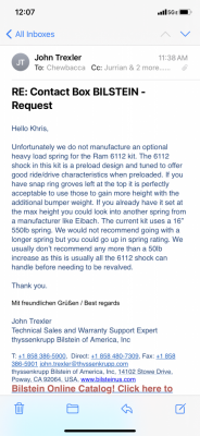

Emailed bilstein about different springs for the 6112 for anyone who may be interested. When I get mine I’ll see how they feel then decide if I want to swap for a heavier spring. 80lb bumper plus winch and winch tray, rock sliders, and possible other goodies.

Interesting! When I spoke to them the basically told me I was **** out of luck. Curious to see how this goes for you!

Accutune has springs available directly through them. Since you have an exact spring rate to work off of I would reach out to them and see what they suggest.
In my head, a 50lb heavier rate means you'll have 100in/lbs more. So heavier coils would put you back to stock settings with a touch more height at each clip. This should relate to less preload for your desired height.

Contact Eibach and see if you can get the spring specs you have from them. Then you can see if Eibach springs will be heavier than 550lbs/inc. I'd imagine Bisltein is telling you not to go with taller springs because the 6112's are stock length. From the tests Hodge did with is 6112's at max droop at max height, he only had 1.5" left in the shock. a taller spring will eat from there. You should have at least 2" droop with Icon, King, Fox etc for the CO's to operate the best for example.

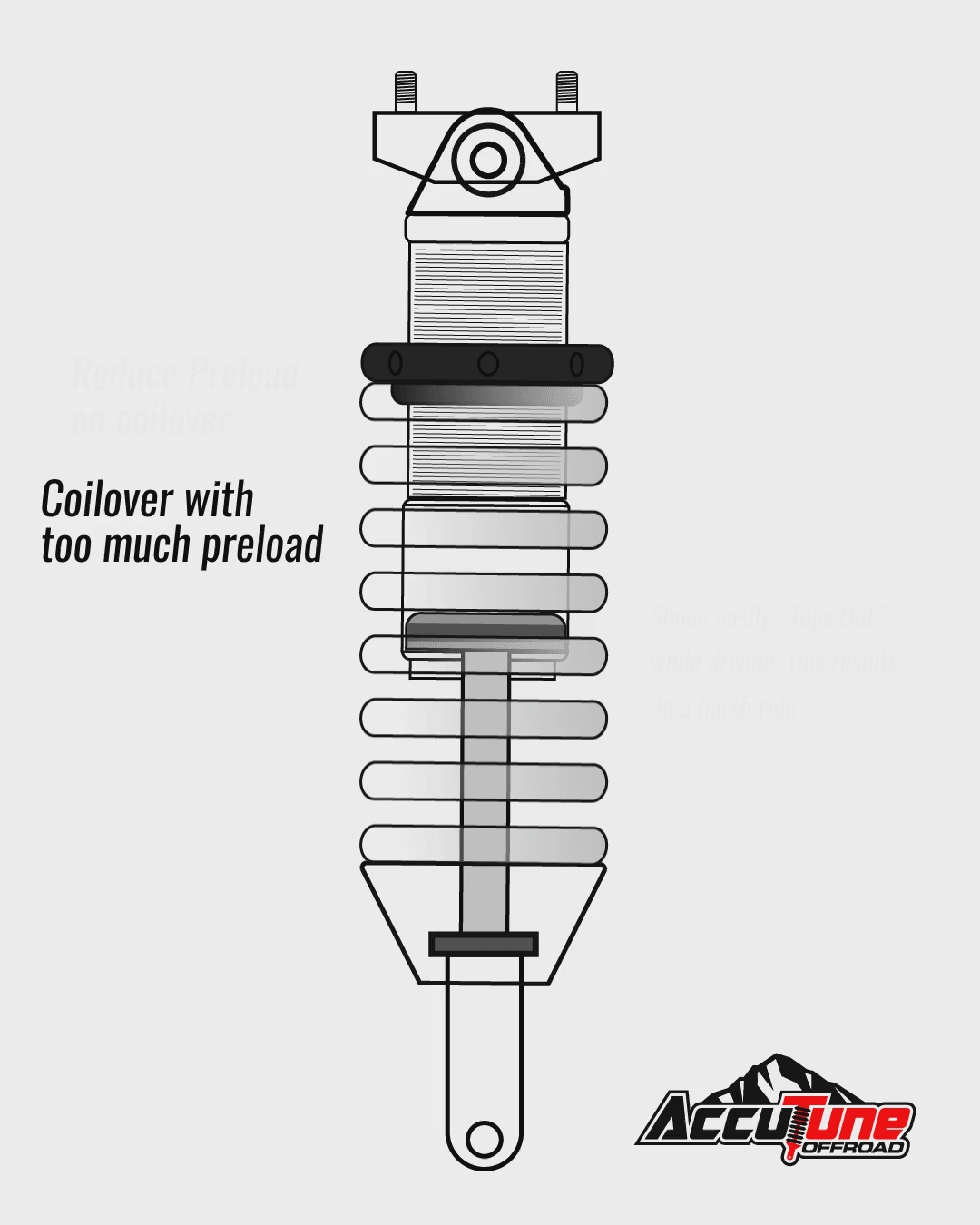

To illustrate you can picture the effects of preload when the shock have to open to its max. Preload doesn't affect the riding much like people think per se. Adding preload is not compressing the spring, in your case, you're simply pushing the position of your springs seats up which in turn will give you more lift at the expense of your shock shaft being pushed further out.you'll be compressing the springs only if your strut shafts can't open it anymore, or if you add more weight than what you have now. If you have too little droop on the shaft the ride will suck and no droop at all will be worst.
