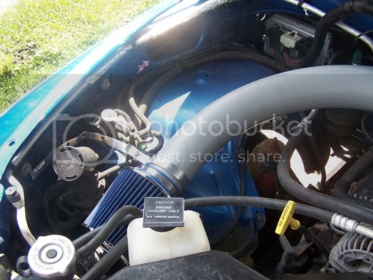

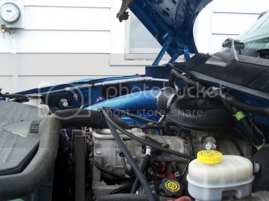

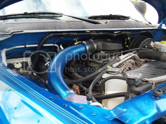

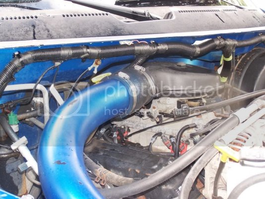

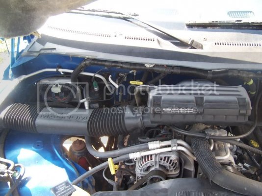

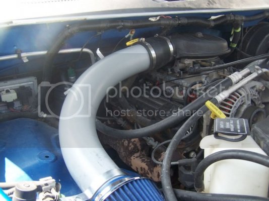

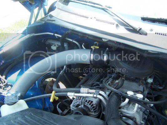

Step1 - Remove old air pipe and hat. Pipe should just come off from fender and hat nothing to unbolt.
Step 2 – Mount the air hat that you have from donar vehicle (Dakota, Durango, Cadillac, or an old CAI) The one from a Dakata/Durango you will need to use the “S’ bolt that goes from the trottle body up through the hat. It will be a tight fit with the firewall right there but just maneaver it so it slides on or you can leave the bolt a little loose and angle it to get the hat on. It will eventually only be able go one way, towards the passenger side.
Step 3 - Attach the rubber coupler from the plumbing department to the hat with the suppled clamps.
Step 4 – Attach whatever filter you would like to the pipe you got in the electrical department, the Spectre filter I used covers from 2 ½ in up to 4 in pipes.
At this time you can figure a way to help support it. As you can see in my picture I just used a strap and bent it to fit, but I will be changing that soon to an electrical conduit holder mounted to my fender.
Step 5 – Attached the pipe to the rubber coupler on you air hat with the clamps supplied.
You’re done so far, unless you don’t want to paint.
For painting take all apart same way installed. Make sure since its plastic to use an adhesion promoter when painting. Then reinstall per instructions above.
You can also make your own heat shield or just buy one of the universal ones. I will be buying one shortly.
