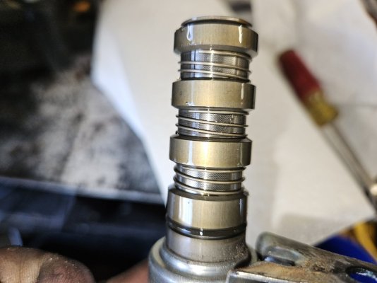

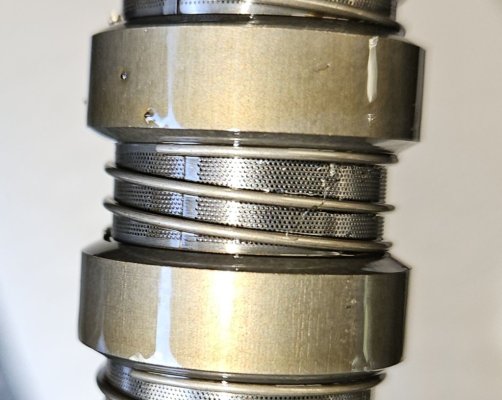

@tron67j, have you cut open your oil filter yet?
Before I figured out I had a lifter/cam issue, I cut open a previously used oil filter, and I did find metal in it.
But I did not have a proper oil filter cutter, so I'm sure I introduced a liitle extra metal into the filter. But it did have glitter in it, and I did find a liitle metal on my VVT solenoid, too.
View attachment 583535View attachment 583537View attachment 583536
Cutting open the filter first might give you a clue before removing the intake.
Watch the little wire harness clips for the MDS/VVT harness that are clipped on the MDS solenoid studs. Mine crumbled. I would remove them if you do remove the intake.
I didn't save the filter, didn't think I would be wondering about my engine at 31k.

Yikes. Best of luck. I have no idea where the oil control valve is on the 6.4L
Sure doesn't look good on the VVT solenoid, though. Man.

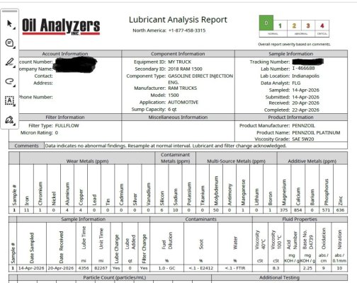

First UOA I have ever had done, sample collected during my latest oil change a couple weeks ago. Looking for comments and suggestions.
This vehicle (2018 pentastar) has been run mostly with pennzoil platinum 5w-20 and mopar MO-349 filter, including at least the last 6 oil changes. This truck has been fed nothing other than regular unleaded gas (87 octane), and no oil or fuel additives whatsoever. My typical OCI has been 5,000 - 6,000 miles.
Wondering about the fuel dilution. It was a very cold winter here and the truck saw lots of short trips.
I don't know much about the 3.6 but in my 5.7 I had a little more fuel dilution in the winter for 2024 to 2025 than I did from summer of 2025 (so it went back down again). More remote starts/idling for me in the winter so lots of short trips could definitely do it.
