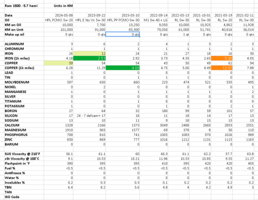

ramffml
Jul 12, 2019
3,660
7,639
ramforum
I was thinking the small amount of copper in my report may be from LubeGard, but according to a post on BITOG, it's not.
Do you have the cooling system? I know that's the current theory for why some hemis in trucks have a lot more copper, it's leaching out from the cooling system due to the esters.
ramffml
Jul 12, 2019
3,660
7,639
ramforum
Got my last oil report back from BL. No real shock, the 20 grade shows a little more iron than what was trending in the previous reports which were all 30/40 grade oils. The only other 20 grade I recorded was Redline and it had the worst values, but it was also a much younger engine so naturally wear metals would be higher as well vs this report.
I think the take away here is: don't let anybody fool us into thinking 20 grade is better for the engine than 30 grade, these 8 UOA's are a pretty clear indication to me that it loves thicker oil.
I added two additional rows, one for iron normalized to 1000 miles and for copper same thing to make it easier to compare to all your other trucks as most of you guys are using miles. Rest of the units are in KMs. Only wear metals that really make sense to normalize are the iron and copper.
The green cells are "best values" for that row, orange ones are worst.
Copper went down, possibly due to this oil using less/no esters (HPL PCMO is a group 3 base oil) so not as much leaching from the cooling system?
Aluminum and Silicon both went down, but this is hard one to nail down without a VOA of this oil because I've seen some trace values for both of these in VOA's. The silicon is a defoamer and the Aluminum has a reason too that David Ward mentioned which escapes me at the moment, so when we see up to 6 ppm alum in some HPL VOAs and get a report back of 3 in my truck, well, you never know how much of that came with the fresh oil vs wore out. I don't think any of the Aluminum values are a problem, they're all within margin of error and expected values for the hemi keeping in mind that HPL also has trace values in fresh oil as well.
cSt viscosity at 9.1 is low vs the heavier grades I normally run, though higher than the data sheet at 8.8. Not sure how the viscosity can get thicker over time, is that due to the oil breaking down or due to dirty oil?
Overall I'm quite pleased. It performed kind of like I thought it would, being a 20 grade and being their cheapest oil.
Right now I am running my second batch of Euro No VII 5w-30, and will swap that out in the fall for HPL PCMO, but this time I will use 5w-30 instead of the 5w-20.
Reason for using their cheapest PCMO? Because it seems to completely remove my cold start knocking/piston slap or whatever it is. Have no idea why, my current oil is knocking again so going to switch back in the winter to PCMO to see if its the formula or viscosity or combination.
Any thoughts, I'd love to hear them!

Thanks brother appreciate you. Yeah the main value in the report is there are so few 20 versus 30 that at this point in engine life prove that 20 weight equals more wear. W#hat oil did you replace this with, hpl? And moly is not a known or suspected antagonist for iron, so I think unless there was extreme load I would be hard pressed to find another cause but 20 weight. Give it time maybe the no vii will smooth out later. Oddly enough 10w30 redline was the only redline my truck ticked on, also a no vii formula, I was not expecting that and have no thoughts either, stumped me.
Yes, replaced with hpl euro no vii 5w-30 (so same oil as second last blackstone report).
All these oils sound smooth and quiet in my truck on hot idle, but only the last run quieted the cold start idle.
Do you have any thoughts on the slight increase in viscosity of the last run? It seemed to climb a little. PDS says 8.8, blackstone reported 9.1 cSt. Not sure what that's an indication of, I do very few short trips in case that matters. Mostly country/rural driving with a bunch of towing trips in the middle.
That last run of 5w-20 had about 9 hours of towing on it. Usually the summer oil gets a lot more.

It isn't uncommon at all, it could be oil thickening or this batch was off a bit. I really would not sweat that. If you consider tendencies, a low viscosity oil with tend to go up in viscosity whereas a thicker oil would tend to go down. Smaller molecules can evap off as a normal function of engine oil. Not sure if that is what happened, I don't know this oil and the % that comes from crude, but the number is so incredibly small I would not waste energy on it. Check voa's at BITOG and known data on starting visc, it is not exact science.
