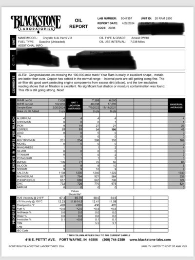

Got my oil report done a little bit ago at 100k miles. I’m sitting at 110k today. I’ve been running Amsoil pretty much since new and added lube guard a time or 2. All oil changes were between 7 and 8k miles.
Quite a bit of towing a hauling miles, and I spin that thing up all time.

Big wow, you see a perfect hemi right there the way it wears. And best of all that oil is built perfect and it is holding viscosity great. Most 0w40's end up in the 10's at this mileage in a hemi. I wouldn't change nada, great report. No lubeguard needed, save the money.

Thanks, that’s what it seemed like to me. Good vote of confidence as I’m planning to keep this truck as long as I can.

This makes me want to try Amsoil 0W40 in my engine. Was this SS or XL.

Me too!! Looks good. I have run PUP 0w-40 of course, and redline 5w-30 a couple of changes, and right now I'm using HPL 0W-40. I might have to give the Amsoil a shot.

Thanks for the report. I have been using this oil in my 6.4 for several years now and the engine is quiet and smooth at all operating temperatures but I have not done a UOA. I am pleased with the oil so far and this confirm's that I will stay on this course, at least for now. I rarely have exceeded 5,000 mile oci's and while some may think that I am changing out the oil way too soon, I really don't care. With the PC pricing of Amsoil, for me around $13 per quart, this seems like REAL cheap insurance.

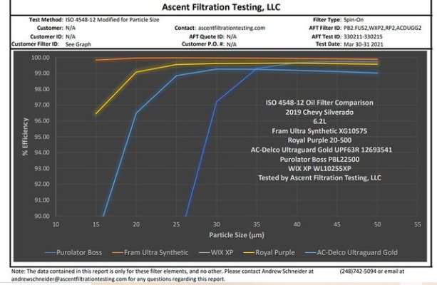

Tests I have seen show as good as and better on some than the Pureolater BOSS filter
Not for particle filtering efficiency. That's what this discussion has been about. Below is the formal certified laboratory test result, not just guys trying to be helpful.

Can you post where you have seen these tests?
It was on line. One where they test flow rate, hot and cold and mix the dust powder in the oil and run it so measure filtration, be sending apple to Blackstone I believe.
