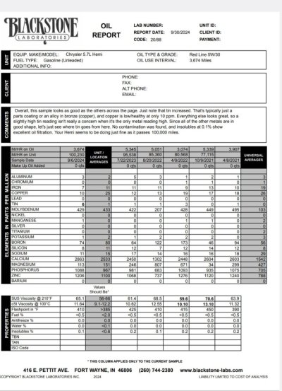

What do you guys think, a fluke or did I happen to put some RL 5w30 that had Tin in it? Everything else looks great.
The thing to remember fellas is this is a hemi tick ram but the wear numbers are as good as any non hemi tick ram, outstanding. There are a couple possibilities, I forget probably trav or Brian had info on tin catalyst in the production and I still believe travel containers is a possibility, it is in many brands Corey look up random voas.
Lake Speed Jr. recently did a video talking about the new Amsoil blend oil and tin showing up in new oil formulations a certain molybdenum being used having it. If you watch the video below from 7:15 to 9:30 minute mark, he talks about it. I would not be getting to wrapped around the axle with that tin count you have with molybdenum amount that is in that oil.
What did you put back?
I went back with Amsoil SS 0w40
What was the oil that you used 2nd of the right for 5339 miles?
What is the price of M1 FS 0w40 for you guys in the US, in comparison to somethlng like Amsoil SS 0w40?
That was RL 5w30 that had a lot of towing on. They noted that it was thicker than normal most likely due to heat
Ah yes, the high tin levels in RL HP 5W30.
I too, had them in several samples and engaged the RL Rep on it.
It's here in our database of info in this and the Synthetic Oil Bible.. (I mean, thread..;))

This oil hpl super car 0w30 just looks like the best hemi oil on paper. As long as that 0w40 SS is keeping you quiet perhaps stay there, but with the forum discounts I think this is competitively priced as redline?
Kind of overbuilt for a short oci, I'd try and push this one at least a couple extra miles.
That was my V_-i.r, g in.. oil sample analysis. (can you believe I had to do this to say this word..lol).
I opted for the TAN and TBN testing as well so we all could have a full spectrum starting point of knowledge with this specific oil.
Nice to see the report making its rounds in cyberspace adding to databases of fellow enthusiasts.
I was a "c-hair" away from my 10,000Km OCI with it, but then traded in my 19' for my new Warlock.
I suppose I'll have to try a 10,000Km OCI with it as my new truck is well broken in with 20,000Km's on her now, in the 7 months I've owned her.
