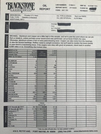

Wear looks terrible to me at 50K. Seen much better looking through these posts.

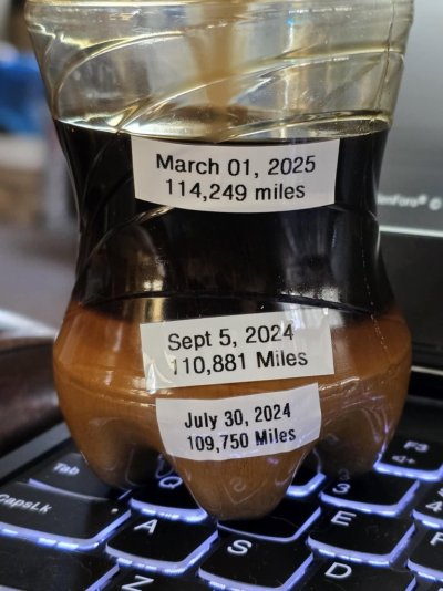

The latest, today, from my Moroso catch can...
This oil is all Red Line 5w-30, with a RP 20-820 filter, PLUS 15oz of LUBEGARD Bio/Tech. Last OCI was 08/01/2024 at 109,755 miles.
The catch can was taken apart and thoroughly emptied, with only one drain, on
September 5, 2024 at 110,881 miles.
I just emptied the catch can again for the 2nd time, this time only using the drain and letting it drip for 2 minutes. Today, 03/01/2025 at 114,249 miles.
Although the pic below shows I am clearly not using a graduated cylinder :rolleyes:
It also shows quite a bit of "nasty". This bottle is a 20oz / 591 mL container and is now about 1/4 full.
I want to go the full 5k miles for the next OCI so I still have about 600 miles to go.
I typically drive less than 100 miles/week, so maybe mid-April for next OCI?
So far all of my Blackstone UOAs are well under 5k miles.
Also, because this next oil change will take me through the summer, my plan is to run without the BioTech. I'm not hearing any ticking and never have. I have read here that the BioTech can not only add moly, but can also reduce viscosity, which might have been helpful with the unusual cold we saw here this winter.
I'm thinking I'd like to take advantage of the full viscosity available with Red Line's 5w-30 through the Summer days when temps can get into the mid-90s and above.
Any thoughts from the collective brain-trust on whether or not I should add BioTech for the "summer fill"? The oil and filter are a given and already waiting in the garage.
*NB: The oil level on the dipstick has not moved, not 1mm, although it is about as dark as I normally see it. My upcoming UOA will include TBN/TAN.

This is outstanding real world test data, thank you for sharing!
Since mass flow is constant (outside of nuclear reactions where some mass is converted to energy), the oil residual in the catch can had to lower the amount in the crankcase. The issue is whether it's enough to be noticeable or measurable on a crude dipstick level. In addition, it is not all oil - it is an emulsion with water from combustion blowby.
Look at the amounts in the bottle - maybe 4 ounces max. between the last oil changes? Hemi sump is 7 quarts. 1 quart is 32 ounces. 7 x 32 ounces = 224 ounces fresh oil per change.
Percentage in catch can = 4 ounces / 224 ounces = 1.8% Is <1.8% lower oil level on a dipstick perceivable? And it is less than 1.8% because it is not pure oil in the catch can.
Regardless of the physics, your catch can once again adds to the database of worthiness - the gunk in your catch can would have been routed right back into the engine, impinging on the the intake valve stem, piston crown, and valve faces, adding to carbon deposit buildup in the engine.
Which causes bad things, man!

Thanks @HEMIMANN !
I guess what I was trying to say is that with over 4k miles I can see no loss of oil in the sump from any causes, like burning it, leaking it, etc. I'll gladly put ~2% in the catch can.
And after seeing the infamous chocolate milkshake from the catch can, which has not been there previously (and almost having a heart attack), I immediately checked the dipstick for the same horror, but the sump oil looks good.
Engine still runs quiet, smooth, tick-free, no CELs, and no misses that I can detect via my butt-dyno.
*Also, I just finished a tankful of my usual Top Tier 91 octane, AND, 1 bottle of Red Line Sl-1.

Right - you don't want to flow 4 ounces of gunk through your engine every 4-5000 miles!
Imma put one on my 6.4 shortly.
Your cylinders are nice and tight with this little amount coming out and no noticeable change in dipstick oil level. Catch can will help keep it that way.

It also coats the inside of the manifold and intake ports with an oily mess,that takes some work to clean up.Throw in the fact the crud sucked through the pcv system effectively lowers the octane rating of the fuel your using on top of everything else. The guys claiming a catch can isn't needed or is a waste of money on a hemi,i dare you to pull your intake manifold,go ahead don't be chicken,it's only about a 30 minute job to remove the intake,lol
And here I was thinking that a catch can was a waste of money, time, and did nothing to benefit the health and longevity of ones engine ;)
Any engine with pcv looks like this without a "breather coalescer". Which is what we called.it in industry. I dislike the catch can term - sounds like little kid slang.
