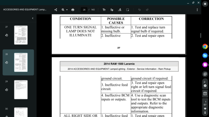

@Texans18 what does the bulb socket look like on the turn signal look like? Might be a bad socket which is replaceable.
Sounds like ground or socket, though wire "could" be bad. Check socket for power to it with a meter. They are real cheap, U can even get a low end meter for like $15 at TSC. U do not need the $129.00 one, lol.
