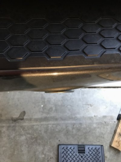

I got it from Nick@GotExhaust, hes a vendor on here. I believe I paid roughly $140 for the muffler, $20 for the extension pipe, maybe $10-$15 for all the new clamps (mine could've been reused I think but nah), and it took maybe 2 hours, but I'm slow and sore so I took a lot of breaks.
I didn't weigh it, if I had to give a real guess, id guess 25-30 pounds, its quite a difference in size, if I get bored ill try and weigh the old one to compare.
No drone that I can hear and when MDS kicks on it doesn't sound bad. I had a 2012 Sierra with MDS and a Magnaflow, when MDS kicked on it would vibrate the whole truck,

Just got done removing and reinstalling after grinding down the alignment pins and taking a little more off the extension pipe. Everything is flush and perfect now.
For anyone wondering, I weighed myself holding each muffler and I came up with a 21 pound weight difference.
