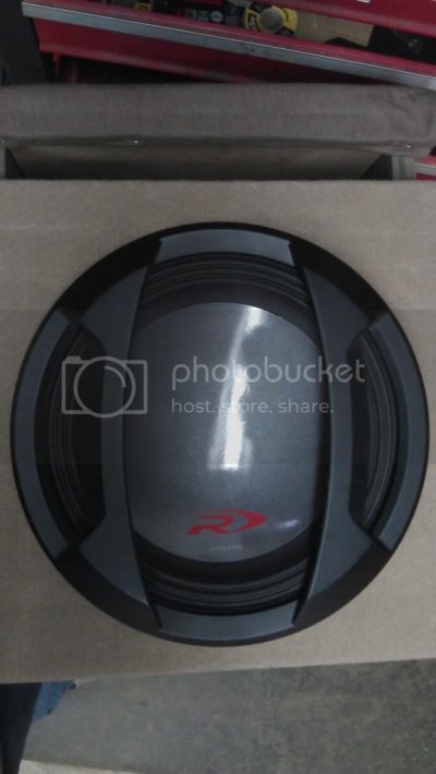

Well this is what I came up with. It's right at 1.1 cu ft per sub. On the low end of the 1-2 cu ft Alpine recommends, but well within specs. And it is loud. I am running it off of an old reliable Kicker 1200.1 running 1200 watts rms at 1 ohm. It has one sub downward firing and one rearward firing with the port over the rear sub. I also used speaker grilles from the Alpine Type E's to cover them.

Looks good

It's hard to compare since it was 1 sub at 600 watts and now it's 2 subs at 1200 watts. Plus it being ported. But it seems like it is more than twice as loud. It feels like it is shaking the truck to death.
