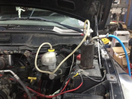

Fabricated a brake fluid pumping thingie wich leaked horribly since I rushed putting it together but otherwise worked flawlessly, I used motul rbf 660 racing fluid, overkill but why not. Took me about 30 min to swap the oil, awesome bit of kit this pumping thing.

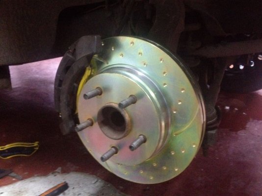

New rotors and pads (EBC yellowstuff) it's a shame these purty parts get covered up :)
Measuring runout, manufacturer states 0.05mm as max, I got 0.04 as max so I'm good to go.
I did a little test using my iphone G force meter, with the stock parts and old brake fluid I got 0.76 G max braking power, with the new setup I got exactly the same wich was offcourse dissapointing, but I guess the pad/rotors need some time to bed in, I'll run em like this for a week and then do the test again. When I'm happy with this setup I'll add the hydrobooster and see what the difference is.

Very cool brake pump. There is one by Brake Motiv that's manual with a psi gauge, but I like the DIY-nature of this!
The motul fluid is by no means overkill. I managed to boil the stock fluid and once it boils, it's almost useless. I rather have a bit more headroom where it matters. I also have similar rotors, but mine are by brakeperformance.com, not sure if yours are the same brake rotors.
