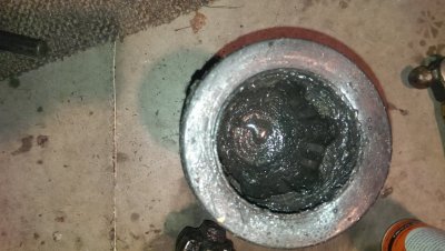

Mine was definitely the CV at the right front wheel.
As you can see, the hub part was worn totally out. The clicking I was hearing the shaft spinning in the hub.
