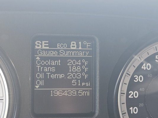

Got stuck in horrendus traffic in a parking lot, as I was pulling in to get gas, my dinger went off.
Coolant temp high, 240°. SHIIIIIT!
Shut her off, waited to cool.
I have coolant on driver sde of rad, a little on crossmember below ac compressor.
I went in and bought a pack of spring water and slowly added to rad, only got 4 bottles in, about 2 qts.
Temp was 160, started her up and let her come up to about 195 noticed my clutch fan wasnt spinning very fast and i was able to stop it with my fingers.
Rad is full, but waiting on a tow truck, $173 for 13 mile tow.
Was leaving in the morning, glad it happened when it did although it still sucks balls.
Thoughts? Rad? Clutch? How do I check the fan clutch?

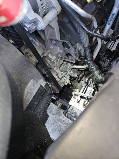

Suggest you invest in a Slant radiator pressure tester, or borrow one. Pump it up to around 16 psi (I think for Dodges) and see if it leaks. If it does find where the water is coming out.
Your pictures show you have the standard Dodge plastic glued-together radiator, not one of Dodge's better ideas. They will split and leak and that may be where your radiator fluid is coming from. I got all aluminum tig welded replacements for each of my Ram 1500 radiators on Amazon for about $250, lots better than the stock crap that Dodge puts in their trucks.
Good luck with your dinger too. Help with that is beyond my level of knowledge although I understand they have pills that work well. :)

Yes, just the stock radiator. I do believe the driver side plastic is leaking, either at the crimp or cracked. I do have a pressure tester, so I will give that a go first thing.
Also will crack my oil drain plug loose to see if coolant in the oil, I had no coolant at the exhaust and no smoke when I ran it after topping it off, but I didn't run it very long. Had to go out of town, so it will sit until I get home.
