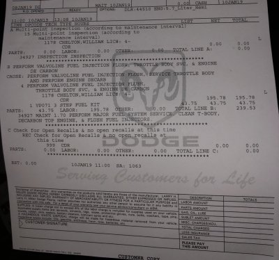

Sorry for the delay but I ended up taking it in late last week and parked it there at the dealer and the next morning I went in for my appointment and waited a bit before I could take it for a test drive. I didn't get a tech to go with on the test drive but the guy that runs the service dept. because of the volume of the vehicles that they were working on. I offered to let him drive and he insisted that I should drive because I would know how to make it do it. Well.. it didn't do it all (of course) it shifted fine and didn't show any thing weird about it. Through out the drive of course he's saying that he's not noticing anything. We take it back to the dealer and after describing what's going on with it he suggests a few different things after thinking it over I decide to just do it. (I'll attach photo from my phone) Unfortunately it's not covered under warranty and is considered just regular maintenance. He says that it should take care of any issues that it's having. When I picked it up later that day he explained to his tech of what I described and said that I'm doing the right service and this should take care of the issues. Unfortunately it didn't take of the issues and I have to do a 100% vitrifaction but my engine seems to have gotten the hemi tick back after they did this. It was getting pretty quiet with RL oil but seems to come back I'll have to keep listening to 100% verify that though. But I'm wondering if its a common thing like reported earlier and its just the colder weather that these 8 speeds aren't a fan of or if there is truly an issue going on

The tick is back from all the solvents that were just run through that engine with the top end cleaning. It could also be injector noise from the solvents, but they should be pretty damn clean now. When I do mine myself I always do it right before an oil change and then change it immediately after running it down the road and back to get that crap out. It gets way darker than normal after doing an induction service on any vehicle I've ever done an induction service on.

Oh gotcha makes sense. It was a bit more noisy than usual for the first couple days but I paid attention to it this morning before getting in and it was pretty quiet again and didn't hear a tick going on
