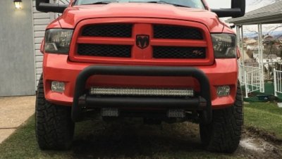

Does anyone know if I order a bull bar for the truck will my parking sensors always be goin off?

I have read they make relocation kits for the front sensors.

They definitely do mess with them. I have the RC bull bar and I'm playing with moving the bar closer to try and miss the sensors path. Right now it doesn't always go off, when it does its when going slow. Once you get moving it stops until going slow again. If it goes off for too long the system goes off and tells you to wipe the sensors. Maybe a thinner bar system would help too. If i can't get with adjustments, I'll look to relocating.
