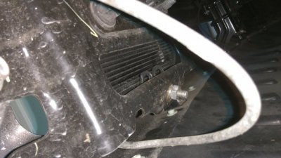

Just bend the bracket from 90° to 45° behind the tow hook holes.
