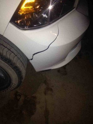

Well.. I was out driving around and went off of about a 4 inch drop off into a small dip and behold. My plastic one piece express bumper is cracked. This is a second one. As a deer got the first one. What would it take to replace the one piece plastic with the 2 piece like the slt?

Don't have an answer man. Is it the bottom of the bumper itself, or is it the plastic underneath? Maybe a pic will help.

My bumper is cracked from the same thing. The bumpers are too fragile.
