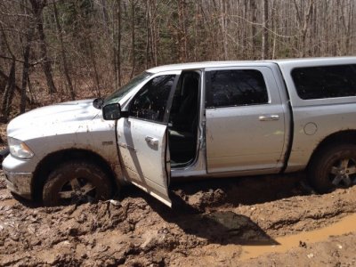

Got buried on a muddy forest rd what do you guys carry on the truck for situations like this we snapped one come along and had a guy bring another to get us out but were stuck for several hours also how do you manage traction control seems to kick in even when it's turned off. Tore off from air dam and broke a fender liner but that's all damage found so far

4 Lo will turn off the traction control.
Stock tires stand no chance in muck like that, nothing besides a winch would have helped you there (without another vehicle)

For those of you thinking why did he try driving through that? I did make it to the river and caught fish this was on the way back out

Tried 4 low couldn't seem to keep front tires spinning tires are wrangler silent armor

When you have the truck in 4 high you can press and hold the traction control button until it displays in your evic that the tc is off. I'm not sure if this turns it all the way off or not but, it turns it off more than just pressing the tc button.

For the 20" rim trucks this is true but not these tires. They are 10 ply off road tires, probably the best tire on a vehicle from the factory out of all of the major brands. They are the best tires I have ever driven on in snow, I haven't taken them in mud but sand they were awsome too. Not too many tires will clean themselves out like mud tires do.
I would suggest 4 hi and holding the tcs button for 10 seconds. In mud you need a lot of wheel speed and 4 low won't give you that.

You just needed a faster running start and you would of shot right across that mud hole. Hit it wide open! :p

- winch
- carry four 4' lengths of 2x8 or 2x10 that you can wedge under the tires and give you a rolling start
- air down the tires
- phone a friend :)
