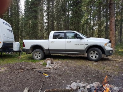

I own a 2012 outdoorsman with 255500km, I've done the manifold studs 3 times and a water pump.
I've owned it since new, never had any engine troubles at all. Tows our 5500lbs family camper all over alberta for the past 8 years religiously.
I run full synthetics front to back, diffs included.

That's great to hear, I'm actually researching shorty headers right now. I'm planning to run shorties so I can just leave the cats alone instead of altering the factory emissions systems. Figured I go ahead and knock that out of the way to avoid having to drill out a broken bolt in the future.
