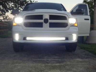

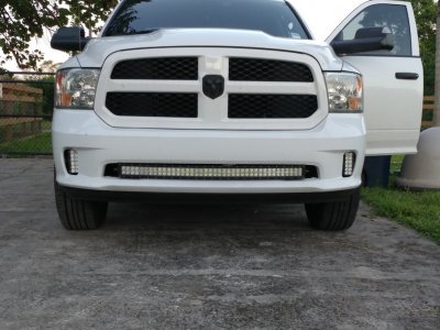

Hello 7" lights bars! Had some issues w led kit i had put in and my lenses had some hairline cracks plus I didn't want to spend the $ on the brackets or conversion kit. i read on here somebody used factory brackets to mount 7" light bars. So i did the same.

Bro honestly i wish i had taken some pics while doing and installing it but my time was limited [as usual]. It was pretty simple. I got 1"x36" aluminum flat bar from home depot that i used to make the brackets that i mounted the same spot the oem lense mpints in the bracket. Some bolts washers and locknuts too. Wired them directly into oem plug.
C-shaped w/ each part 1.25" was the winner i actually used. That pic is of first attempt.
I want to take the passenger side out and squeeze the bracket closed a little. Bending the aluminum was a little tricky. Maybe a pre-made bracket that size exists but i had to wing it at home depot.

Maybe it’s the camera angle, but is the passenger side light in more than the driver side?
Yeah i need to adjust that bracket a little

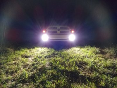

Do you have any night shot with them on?
My gate doesn't show the reach too good but they're supposedly flood beam style.
