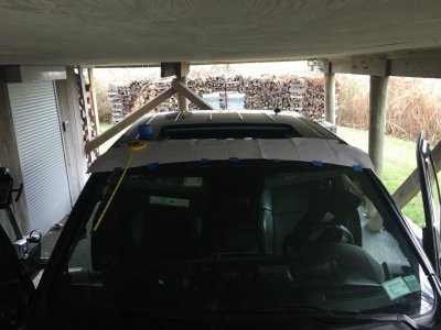

Here is a few helpful tips:
1. After laying out the template and taping it down (which I found really easy?? not sure why everyone thinks it's hard? It's clearly marked...), use a nice sharp punch to punch a mark into the paint/metal where each hole will be drilled (per markings on template). Do NOT be shy with the punch, hit is pretty good to make a nice dimple in the roof so the drill bit will stay there when drilling.
2. BEFORE drilling the large proper size holes, FIRST use a 1/8" drill bit, and drill each hole location where the punch mark is. The 1/8" drill bit will go thru nice and clean and easy, dead on your spots since you have a nice punch mark to keep the bit from wandering.
3. Now and only now, take the proper size bits and drill each hole to full size. With the 1/8" holes, the bit will go in nice and easy and straight again without wandering.
4. For the large center holes for the light, (I forget, 3/4"?? whatever they are...) I used a HOLESAW, not a regular type drill bit. This made for much less shavings, and just one big round piece after the cut. So just a bit of light vacuuming cleaned up all very nicely. A regular bit would leave much more junk up there...
5. I have the sunroof, which made ALL the work much easier since I stood in the truck with one foot on the passengers seat and the other foot on the drivers seat with my head and shoulders/arms out the sunroof with nice easy access to the roof.
6. I only removed the A pillars, and the sun visors and very carefully and lightly pulled down the headliner about 6" along the top of the windshield. This gave me about 3 or 4" to reach in back by the sunroof. Do NOT pull it down more than that because it will start to bend on the sides which will leave a crease in it. When I was pulling it down, I noticed it started to crease a little so I simply pushed it back up an inch to stop that from occurring and kept vigilant about letting it drop anymore. I have nothing visible on my headliner now. ;)
7. When screwing the light covers down onto the plastic inserts, if they are spinning (as reported above by "Maligator"), just put a bit of sideways/angled pressure on the screwdriver while turning. It makes the insert kind of get stuck on the side of the metal hole to keep it from turning.
Here's a few pics during my install, you can see how far I pulled the headliner down. I had no issue at all with any of this part. Finding the right power was another story. ;)
Oh, lastly somebody was asking about the height of the lights installed, "how much height did it add to the roof for clearance...". Well, NONE. The tops of my lights are actually below the highest part of roof (toward the back) because the roof dips down toward the front where these get installed.

View attachment 117930 View attachment 117931 View attachment 117932 View attachment 117933 View attachment 117934
Good write up, my template issue stemmed from it being folded up and trying to get it to lay completely flat was tedious. Wanted to make sure the measurements were spot on. Also I did it outside and any slight wind gust tried to use it as a parachute. I'm glad this thread has taken off, alot of Info about this mod was kinda hard to come by
