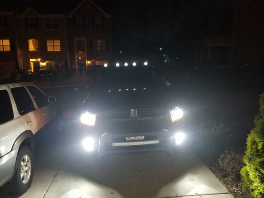

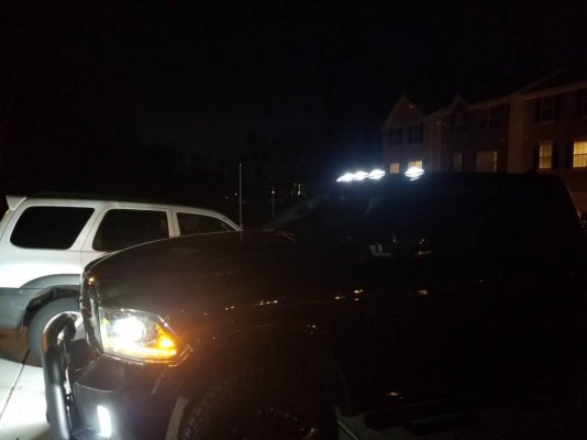

Thanks, I ended up getting them just had to get that right amount of pressure like you said some of the ones i could get to i put pliers on em. Had me freaked out a bit.
Install went smooth other than that, the template was a pain in the ass. I only took the front a pillars and sun visors off and I was easily able to access where I needed to get.
I did put a thin layer of silicon on the inner lip of the rubber seal just cause I'm paranoid. Wasn't a fan of the plastic nutsert Appling the sealing pressure. I tapped into my HID headlight wire for power. Works great! I love how they turned out but I don't know that I would ever do it again drilling those holes had me freaked out even though I measured several times1ba1899968bf1a6d03862e75e5be2380.jpg0af586ad64538db54841128bb229668c.jpg

Looks good Maligator! Did you do recons, or just white bulbs?

Looks great Maligator, so just taking off the pillars and visors gave you enough room to get your hand inside to install the wiring?
What did you do about the metal shavings from drilling?

I guess I should add that I do have a sunroof without it I'm not sure I could've done it just dropping the front half. Especially since I had trouble with the nylon nutsert things. Also squeezing the lamp sockets through the 7/8" holes was a bit of a tight fit and took some work getting them in.
As for the metal shavings I did have my vacuum near the drill bits to catch as much as possible and vacuumed out the top of the liner. Did have quite a bit of shaving.
Also another little issue I had was I used a 1/4" regular drill bit first and it kept wanting to twist and grab the thin sheet metal when it broke through. I then switched to a step bit for the remainder of the holes and it worked great.

Looks Good ! I did mine a couple of weeks ago. I used some silicone to hold the inserts in place. Also a 6mm drill bit which made them fit tighter. Spent most of the time double checking layout.Several times actually.

Looks great. is the passenger giving you a big thumbs down? :lol:

Hahaha, I was wondering if anyone would see that. She hates working on the truck days. I still haven't fully embraced the "happy wife, happy life" concept...lol
Sent from my SM-G950U using Tapatalk
I was just checking out the truck and was like wait a minute whats going on in the cab lol
Yeah my wife hates it to0 but has grown to know thats just how life will be with me. if its not the Power Wagon, its the mustang or its the RZR, or its the kids go karts, etc...
