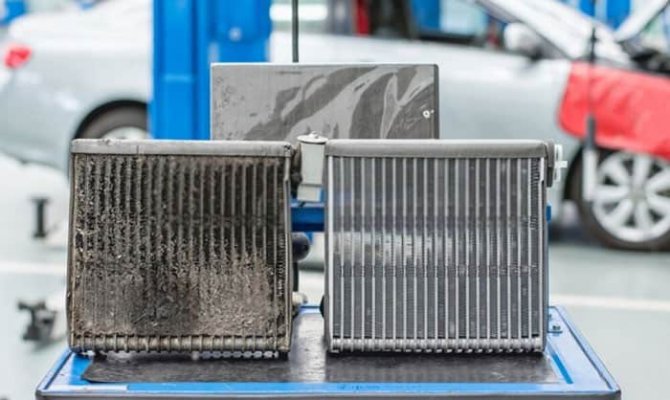

Ram never had even a door for the Cabin Air Filter in December of 2015
In the early part of 2016, they installed the CAF Door
The Cabin Air Filter catches dirt, dust & pollen & that means that unwanted debris does not reach the Evaporator
this would not happen with a CAF installed
a CAF filter containing Charcoal helps to keep out odors & debris
some people prefer a Fram Fresh Breeze CAF
