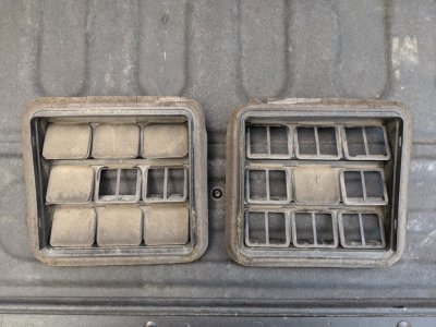

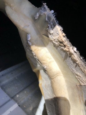

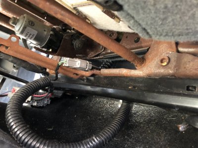

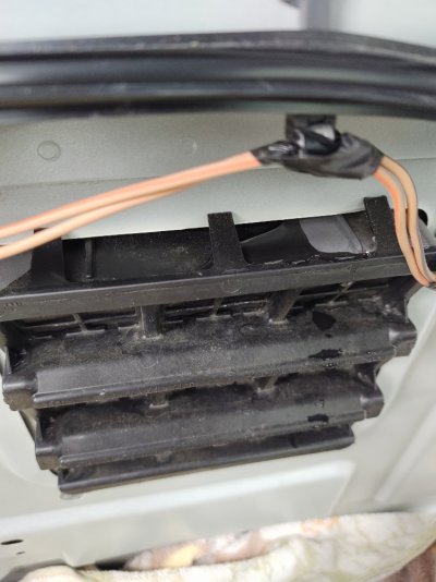

Cabin pressure vents leaking for sure. Over a year driving the truck with a smell, hard to breath, windows fogging and never thought my 2016 Ram 1500 had water leaking from the rear plastic lose factory installed vents. In addition to the health concerns once I noticed my carpets were wet and traced the leak to the rear vents, (thanks to this forum) I uncovered corroded wiring harness connectors, rusty seat tracks and mold all on the edge of the carpet front and back. Needless to say disappointing. Ram knows there’s an issue and even revised the vents with a newer version. This 100% needs to be a recall! Health and safety checks both boxes. The truck was difficult to drive on rainy days due to the windows fogging especially at night, electric harness and connectors corrosion and MOLD throughout the truck. Where’s the recall RAM??
