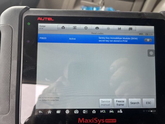

Yes drivers side negative, after cleaning and hooking back up a code was on but then later turned off, heated seats, all lights, ect still work radio lights work but no sound.
I wanted to see if that was the reason for truck activating code p0633 (skim key) truck would turn on perfectly then die within second but next day would run fine without moving truck

No, I didn’t use any cleaner today just wire brush real fast didn’t have much time to mess with truck, was already dark out. But I will properly clean and coat them tomorrow.
As of the battery’s are little under the 2 year mark and reads little over 14v in truck with it running and ac on
Noticed too that my heated seats light used to flash and won’t turn on, but now they work

Back to tracing wires then. Also looking to see if the positive terminal has a matching wire.
No positive terminal doesn’t have any wires that’s not attached to terminal
