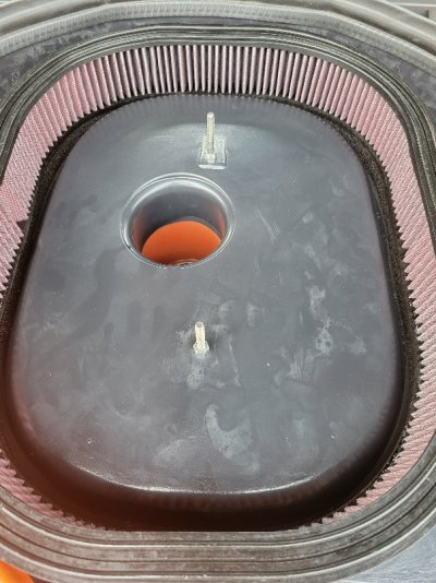

I purchased a vararam air grabber for my 2011 ram 1500 sport.at first I was very please with it.lo e the style and performance up until I noticed dust on the inside of the intake,upon further investigation I found that it wasn't sealing on the front corners.

View attachment 468660as you can see, dust inside
You already have the best one on the market, you just need to learn how to put the lid on correctly.
It's not sealing correctly because you're not re-assembling it properly.
You won't get any dust if sealed correctly, fwiw.
Put your filter in the channels on the base, they're not gonna stay in the channels, but you'll fix that in a minute.
Now, starting at the rear (make sure the lids facing the right direction) start at the back and squeeze the filter until it seats in the top of the lid and keeping constant pressure on it as you run your hands around to the front pushing the filter into the top of the lid and bottom at the same time until your all the way around and now put the bolts on.
The filter should be in the "channel" all the way around on bottom and top, if not, just push in on that spot and it'll pop in place. Now tighten down, done.
Now it's sealed correctly all the way around, makes a difference!

I've done all that,I've watched videos ect.its sitting in the channel just fine,the front corner just don't seat down all the way
It will if you run your hand around the perimeter pushing it in, keeping the other edges in at the same time.

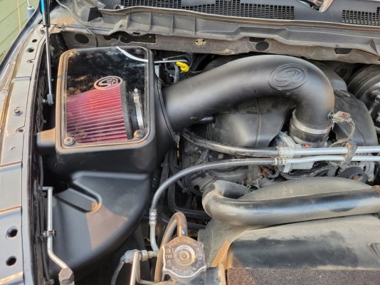

Well update,I went with the s&b and couldn't be for happy,still feel a better pull over stock and the filter along with everything thing else it constructed very well,definitely a happy customer

I've always been happy with S&B
