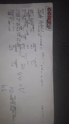

Which cam would give my 2nd gen a nice lope with using stock valve springs ?
This is what your asking for
