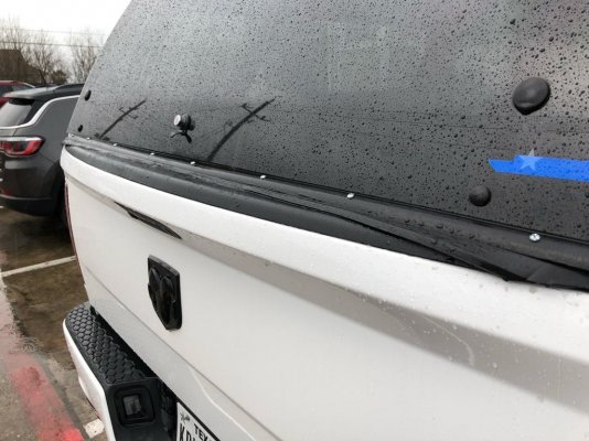

i dont have one for sale, nor do i have this truck anymore. just wanted to let you know that i had a 3rd gen shell on my 4th gen 6.4 foot bed. i had to modify the rear seal a little, but it fit the body lines and paint color extremely well. it may broaden your search and make things easier.

definitely. i bought this one off a 2005 ram 2500 for around $500. modifying the seal was actually pretty easy. 7e8f49ea15c4cd062dad6b8a0aaf6a2f.jpg
feel free to shoot me a message and ask any additional questions if you need. i dont want to derail your thread.

Curious what you had to do to the rear seal to make it fit?

just added this pic above, but here’s a good idea. c92c60d7554d87aa4330a176b8b2fef4.jpg
i trimmed down the plastic portion of the glass, drilled holes, and bolted a garage door seal (this was the heaviest flex barrier i found) and trimmed it. it worked great
