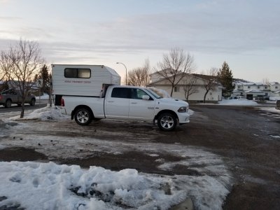

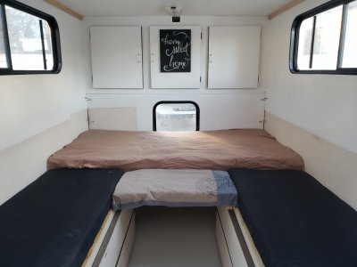

Myself, I converted a Medic unit into a camper for my girlfriend myself and our pup. Just a simple space for sleeping in. Has a heater lights and outdoor stereo, nothing special just a place to sleep that's off the ground. Was a $500 project.
View attachment 126997 View attachment 126998
Oh that looks good! I'm a carpenter by trade so I'd rather build something or fix something up myself! And of course building on a budget, couple things more important right now. Thanks for sharing, looks like it would be really roomy in there.

Yeah its not to bad for a 8ft x 6ft box haha, when I got it one whole corner was rotted out so we replaced that and converted the inside to have a bed and 12v power, next winter I might add a small propane heater from a tent trailer. Not overly hard to find if your willing to travel, I think I saw a couple for sale in Saskatchewan!!

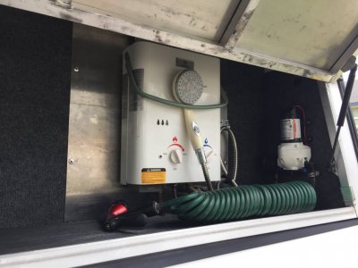

If you plan on going with a camper shell here’s a few things I did to mine. 1” thick insulation and carpeted, interior/exterior lights, fantastic fan, 12v heater (temp install), 100w solar panel, 500w inverter, two 12v marine batteries, tankless water heater, 8 gallon water tank, removable bed box and AC window unit with generator (summer).

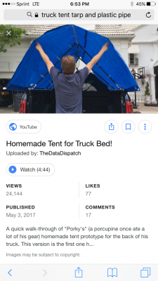

I use (2) 1" pvc pipes, bow them, and install them in the stake bed holes. Then i cover it with a tarp. Cheap, easy, and sets up and easy to take down.
That’s an awesome idea I think I’ll do that
