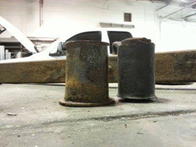

So I finally got to getting these done tonight. Truck rides SOO much better! Not rigid or harsh , just sold and smooth on not so smooth roads. Like the whole rear of the truck works smooth now. It has a fluid movement to it over bumps. I think the bad bushing were causing chatter on washboard type roads...even with the new shocks I did last month. Only 1 of the 4 bushings was good and came out in 1 piece. The other 3 were deteriorated away from the steel sleeve and floating side to side rubbing on the spring perches. Causing VERY annoying rattles and clunks! Took a few pics of how the bushings came out and of the wear that was starting on the front perches. Just something you guys may wanna look into if you're chasing down noises and crappy ride. Also, if anyone was wondering, the kits listed up to 05, will work up to 08. I figured...but now we know for sure. Start to finish was 2hrs 15 min. :D

quick follow up on this after about 100 miles. ITS AWESOME! Best $60 i spent on the truck! Ride quality is SOOO different, solid and stable. Use to chatter real bad is corners with any type of bumps or big offset cracks. So bad that it would just about change lanes in the rear and take the wheel out of your hands. I figured it was just a truck thing. Shes planted now! Im gonna do the rest of the truck soon and a rear swaybar to make it a real turn burner! (or not , LOL!)
