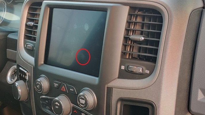

Can these marks on the 8.4 screen be polished out?

I'm not sure how this happened, but it was clearly while installing the Kicker amp, and running the t-harness. It's only visible in certain light and the pic looks worse than it does in person, it looks more like the spot circled in red. Is that some coating scratched, because I don't feel anything. Again I can only see it in certain light, but I don't like it. Glass cleaner did nothing to help it.

No but a screen protector might hide it. I recommend this one, it's pricey but worth it.
https://www.amazon.com/dp/B01DVSYTTK/ref=cm_sw_r_cp_apa_i_bkKJFbKCATRHQ
It goes on best with the radio HVAC bezel removed...

I'll look into that. To be honest it is only visible when the screen is off, and at certain lighting. I can't see it at all when the screen is on, but if bugs me for some reason.
It'll get worse. The factory screen protectors are very fragile .

I'm going to buy a new screen. They don't seem too hard to replace. I was trying to be careful with it, so I'm not sure what scratched the coating, but it it happened.

Bummer dood. I was going to suggest maybe trying plexus polish. Screen change will certainly do the trick. I feel you on things nagging at ya no matter how small and inconsequential, it's a disease...

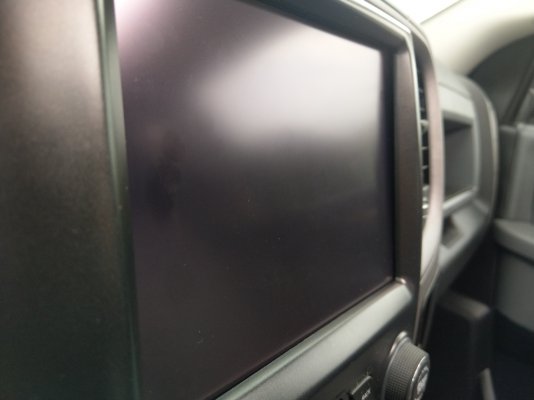

The truck is a 2019. I've only had it 10 months. It's my fault. It happened while I had it unmounted trying to remove the factory and plugs and install the t-harness. I didn't notice it at the time, but it wasn't like this before, so I had to have done it. If the truck was older, I might live with it, but for a few hundred I can get a new screen. If I don't, it'll bug my every time the light hits it and I see it.
Most of the time you can't see it, but sometimes you can.
I'll definitely put something on the new screen just so it doesn't wear over time. I may try polishing the original screen and just removing the antiglare or whatever is on there that made these marks. If feels completely smooth, so it's not the screen itself that is scratched, but wear in the coating on top. I'll try that after I get a new screen in case I F it up. If it works, I'll keep it as a backup.

It's not your fault, it's a very common problem for 2018+ 8.4 radios. All 4 that passed through my hands had this and the pristine screen I kept did this after a few months of light use. The screen protector I mentioned should cover it and make it unnoticeable. A new screen is not necessary IMO.
If you decide to go and get a new screen anyway the part number you need is LA084X01-SL01 or LA084X01-SL02 (both are compatible).

No, mine was pealing up and had ghost touches. I also would caution against opening the radio without need as it is passively cooled and the heat sinks inside are thermal tape which some say should be replaced and not re-used.
The screen protector is a two pack. If you don't like the result you could always proceed with a new screen, but I believe it may be harder to find them under $200 now.

You know, you said this wasn't mishandling on my part, and I assumed it was, but now I don't really think so. I went to adjust the front to back fader and two of those marks in my screen are exactly where those controls are at, and I mean exactly where there are. I bet this was just getting worse over time and now I noticed it, or had assumed they were finger print smudges.
It's not like I adjust the fader all the time, but the chances of two of those marks being exactly where they are is pretty near impossible.
I don't know how they can deny a claim simply because I have aftermarket stereo equipment installed as it is unrelated. My truck is 10 months old with 8k miles on it.

They've been swapping whole radios for factory screen protectors coming off...I suppose you could ask your dealership? As far as I know, there have been no changes to the screen protector material itself.
The factory protector looks and feels great but is not durable past 6 months IMO which sucks for something "permanently" attached.

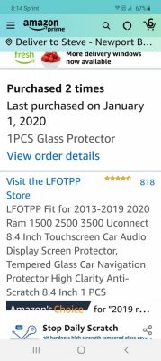

I would try a claim, added amp n speakers or not!
Bought my classic Dec 28th, ordered this cover on the 1st. And its under 10 bucks!
Had the same one on my 17 and to me its a no brainer to protect the screen, same with my cell phone!
