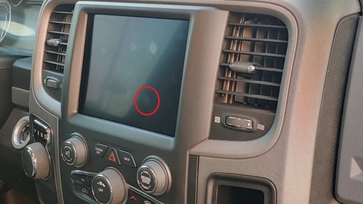

I'm not sure how this happened, but it was clearly while installing the Kicker amp, and running the t-harness. It's only visible in certain light and the pic looks worse than it does in person, it looks more like the spot circled in red. Is that some coating scratched, because I don't feel anything. Again I can only see it in certain light, but I don't like it. Glass cleaner did nothing to help it.

I know this is an older thread, but I just noticed my radio doing the same. Did you have any luck with the warranty covering the issue?
I haven't brought it back to the dealer yet, but I can say it looks much worse now in the course of a few months than in that pic. Basically once it starts, it deteriorates quickly. I need to get to the dealer here pretty soon. I'll report back how it was handles after I do. My truck is still well under warranty, 13 months old and about 9800 miles, but I need to quit putting it off.

Agreed. I polished most of my issues out with toothpaste and put a screen protector on. Pretty much cleaned up my problems. After reading about some of the issues with replacement radios, I will not be bringing this up to the dealer unless there are other issues with it.

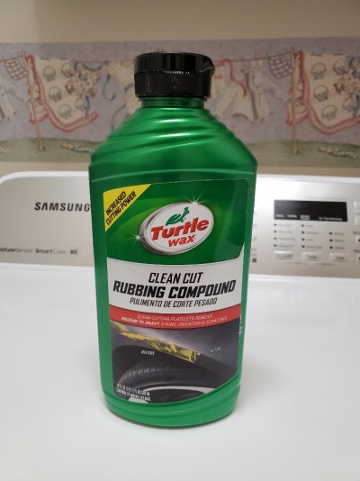

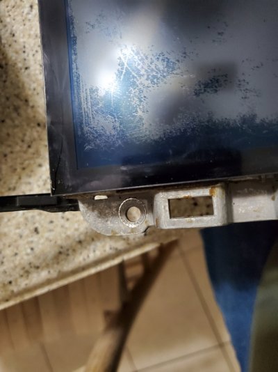

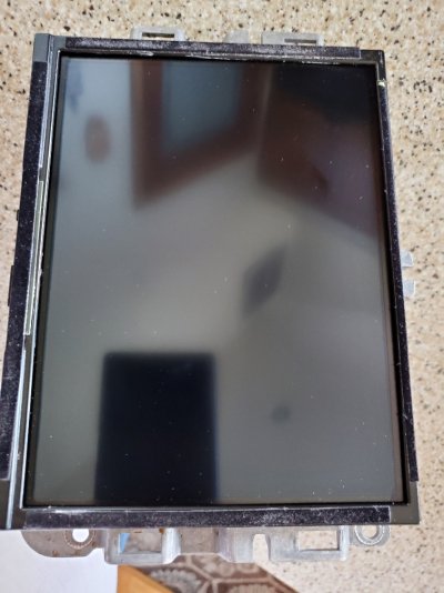

I just received a uaq from a car-part.com vendor. Screen looked like about half of the factory screen protector was worn off. I used rubbing compound to remove the rest. Now just glass. f97f3c73b49df47d4dc820fd80090b45.jpg655db6d1a4d1c649d8635c4c01fcce1b.jpg

I recommend this protector for a factory like anti-glare (but better). Apply with the radio out and/or the HVAC bezel off as it covers the whole screen...
Looks great! What exact product did you use?
