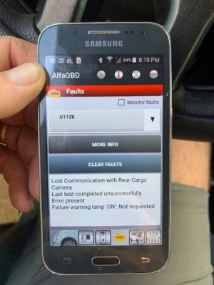

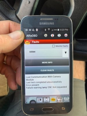

All is working well, but I still cant seem to clear these DTC faults even though it's working now. Any reason why or something I need to do?
Yes I did change the "LED CHMSL Lamp Present" to yes after I was getting a DTC for that as well.
U112E - Lost Communication with Rear Cargo Camera
U0264 - Lost Communication with Camera Module
View attachment 227127 View attachment 227128
I think I had to give it time but I'm not positive. I'd ask in the AlfaOBD thread with a brief summary just to be sure.
I've given it 24 hours or more, however I haven't actually driven the truck. I know sometimes a drive is required for some settings.
