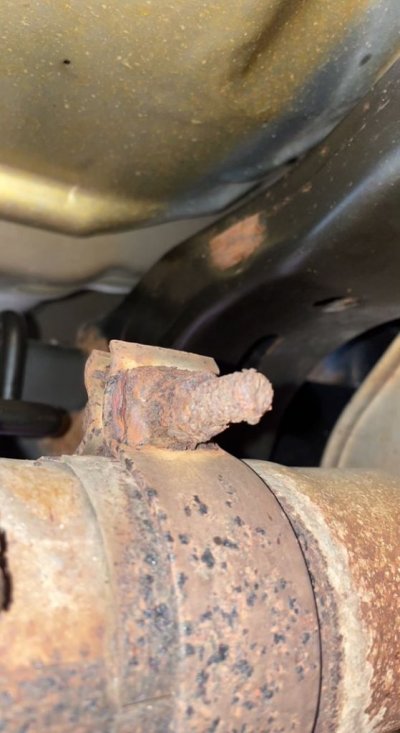

Aw man! Went below deck to PB Blast the old muffler clamps and I see this! I’m too old for this ****…might take it to the shop to install!
If you have an angle grinder you can just split the strap. No need to cut the bolt off. Cut down the side. It pops off easy.
