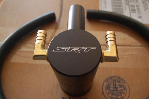

Basically the biggest difference is quality of materials, split can vs. single case, drain vs. threaded top.
I think $350 is way too much, $50 seems a bit cheap and I'd want to see it before I bought it and, $100 - $150 is the going price for a well made, effective catch can.
I have a 2006 Chrysler 300C SRT8 and have run a BT catch can on it since almost new. My throttle body stays cleaner, it's amazing to see what it traps and keeps from going back into the throttle body and intake manifold; and it fits well. Despite the difference of opinion on whether or not you need it, bottom line for me is that it doesn't add any HP to my vehicle's performance but it does let me keep the 425 HP I have.

Where did you get your catch can I like the look especially since it says SRT on it?
I got that one from Billet Technology
Thanks, checked them out and prices are reasonable. Not sure if I am going to go all nuts under the hood cosmetically, but just in case, they offer color options and it has a clean look. I might just go with this.
