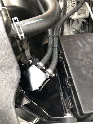

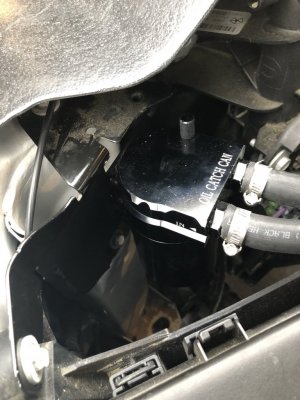

Hello Ram Family,
Just finished installing my catch can. Could not find myself spending 100+ dollars on one so I got off amazon for 39.99 and bought 6 ft of hose to do it myself mounting near the battery and it turned out pretty good. I’ll pull it in a thousand miles and see what it picks up. IMG_2966.JPGIMG_2965.JPGIMG_2964.JPG

Everyone I have seen install one has had something in it in first 300 miles. Did you just check the dipstick or unscrew bottom? If you pull dipstick out when running it has powerful suction. I even put mine at a little incline from the TB.

Just out of curiosity (OP)... Why did you mount it on the other side of the engine bay? Seems like an awfully long way for the fluids to travel.

Looks like he has an aftermarket air box. Maybe there wasn’t a lot of room left. I do agree it looks like a long distance but the vacuum “should” pull the oil through those lines IMO. Unless there is real low point in the lines where it will collect and eventually/possibly block the system.

really stupid ? where do you run the hoses to hook them up ordering amazon can today
rotwiler
Oct 20, 2017
1,019
517
Washington
Hook it up where line goes into pcv and below throttle body. Use 1/2 inch brass push connectors and good fuel line and is 10 minute install. You will see a plastic line going into rubber connectors at pcv and below TB, remove plastic line and replace with line to catch can. One below throttle body is in to catch can, one to pcv is out. I said that reversed PVC side goes to in on can, out goes to under throttle body, thanks all for catching that.

If it is a k&n I am almost positive there is nowhere on the other side of the engine bay you can hang the $42 catch can on the ac lines. The can seems to be made to mount on those lines, so something would need to be fabricated to install it over there in another location.
