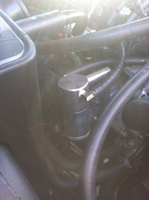

Finally had a good day off to install my can. My question is the 90* barbed fittings do not tighten in the correct direction they need to be in. Is that ok? I put plumbers tape around the threads... seen others do this

long as you have plumbers tape on it you will be ok. Mine are the same way. I have no leaks and its catching the crappy oil still

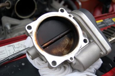

Left no Catch can
