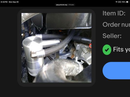

Thats what i bought. Gonna get it Wednesday. Only issue i noticed was the PVC and intake manifold hoses are crossed in the pics in the advertisements, except for their website. Directions says the port closest to the front of the car goes to the intake manifold vacuum, the other goes to PVC fitting towards the back of the intake. The photo on the right is the correct one.

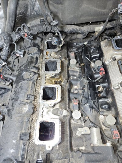

I guess I'm in the minority and don't see the need? I haven't had one for the past 9 years and everything seems fine? What am I missing, and if they are so important why didn't the engineers think of adding one?

Check out Ed's thread ,i'm pretty sure he's got pics of his intake ports posted,you'll see why a catch can is a benefit on a hemi.
The Hellcats come with a factory air/oil seperator,but it dumps all the crap back into the oilpan.
The engineers are controlled by the bean counters,and the bean counters aren't gonna allow them to add a catch can,and increase production costs,throw in the fact,the majority of owners would never dump a catch can,and you can see why they don't put one on the naturally aspirated 5.7's and 6.4's

Thanks for explaining that Rick, and for the pics Ed. Seems like someone asks that any time there’s a thread about catch cans, and for this the pictures speak a thousand words as they say.
