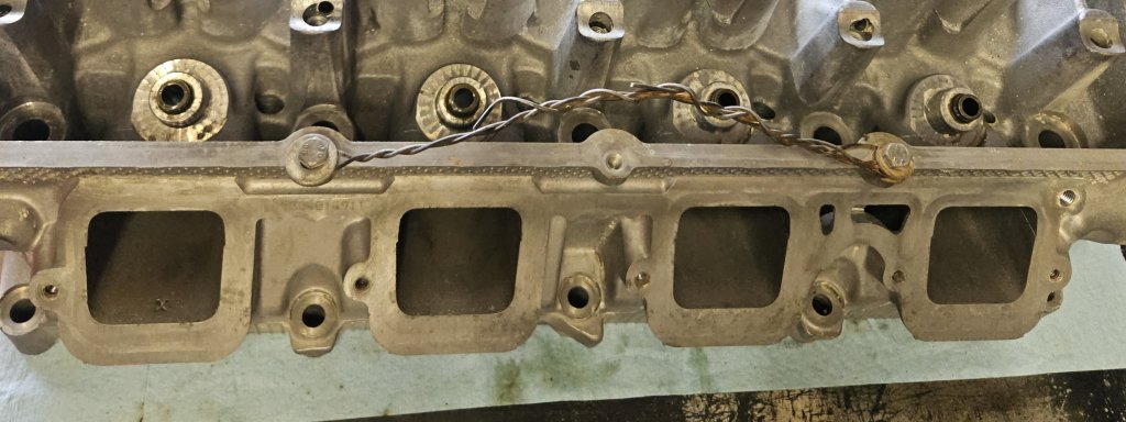

I didn't get mine quite as clean as yours, Rick, but they're a damn sight better than when I started.

You did a wicked job of cleaning up your heads and pistons Ed,i dare say no shop would ever do as good of job as you're doing :waytogo: I'm not easily impressed,but you've definitely impressed me with your attention to detail;)

That was a pure 200k with not much done. I ran Lucas Fuel Injector Cleaner a few times and RedLine once or twice, but that's it. Intake bolts were tight, and I'm embarrassed to say I never once cleaned my throttle body.

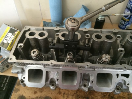

This is what the intake ports should look like.
That head's been run with a catch can? Or is the picture after the heads been cleaned?

It's been run since new with a Moroso can,so all it took to clean them up like that was a quick wipe with a rag

A catch can will not catch everything. So no intake ports will look that clean after any appreciable mileage. But running a catch can greatly reduces the amount of build up that will occur inside the intake manifold and intake runners. Notice how clean the cylinder 1 and 2 intake valves are in Ed's pics in post #18. Having port injection keeps the back of the intake valves clean, but does nothing for the rest of the intake system.

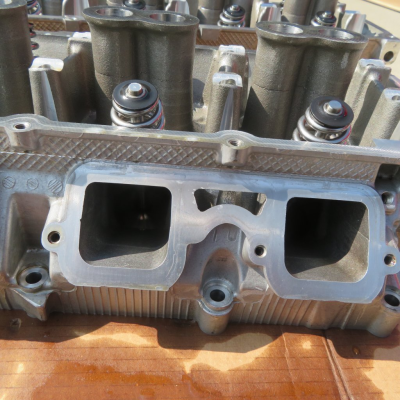

These were my heads when we did my cam almost 10 years ago,and it had had a moroso can since it had 120 miles on it. The truck had about 20,000 miles on it at the time Mike.This was with no cleaning at all,just the way we pulled them off the truck
Where Kurtis says "update" about half way through his #4 post,everything after that is my truck
Ed you'll notice we didn't clean the piston tops,or heads,lol. I drove the truck to Kurtis's place about 8:00 that morning,and between Dylan/Kurtis and I it was back up and running by 4:00 that afternoon,but i already had the headers /rad and bunch of other stuff removed when they showed up around 10:00. I bought pizza at 5:00 and was back home with the truck a little after 6:00 that evening,so we didn't waste anytime cleaning parts like the heads,lol
We did it at Kurtis's place as he wanted to get more pic's to add to his cam swap thread ;)

That’s pretty impressive but it’s only 20k miles. IMHO the Moroso cc is one of the better cans out there. I’d be interested to see the intake runners after 100k+ miles. Or maybe a pic with intake runners after 20k miles with no catch cans. That might convince some of the naysayers out there.

I kind of think it also has alot to do with the way the vehicle is drove to.The truck was drove hard right from word go,and was on the dragstrip racing when it had a little over 400 miles on it.The easier drove vehicles seem to carbon up the intake ports and collect more oil in the manifold then one that has the crap drove out of it,lol.Higher velocity airflow through the manifold doesn't let any of the byproducts that make it past the catch can,to actually collect in a manifold or port and create a build-up of oil and carbon
