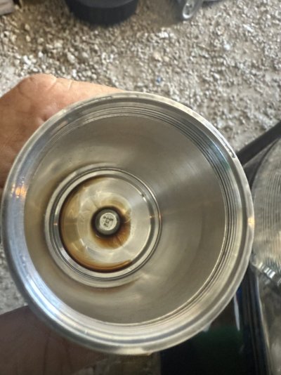

Catch can 100 miles since install

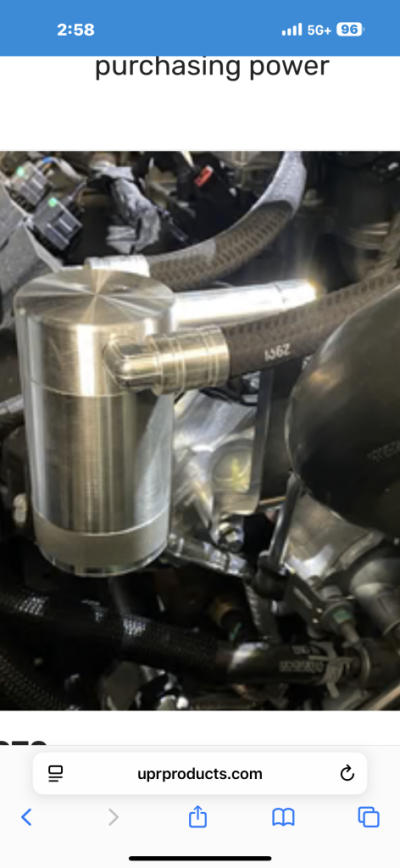

Don’t know what to inspect on mine

What brand of can did you buy.The Mishimoto and Moroso cans are 2 of the better quality cans for a basically stock 5.7 truck.Some of the cheap ebay cans aren't quite as efficient at condensing the oil out of the pcv system.
But for a 100 miles as @mikeru stated that's about par for what one will gather up,especially if that 100 miles was mostly highway driving

Is this an indication something may be wrong? I thought thr UPR was one of the good ones.

No, this is not an indication that something is wrong. What you saw in your catch can is normal after so few miles. Check it in a few thousand miles and see what it has collected. In a healthy engine the can should not fill up between 5k mile oil changes. In my F150 (EcoBoost) I have to empty the UPR can half way through an oil change interval. But that's a 12 year old truck with 150k miles.

No, give it time. Look at the pic I posted. There is a label at the bottom.
The 1st time I emptied my catch can (Moroso) was after 2 months and more
than 1700 miles. Just barely filled the bottom of the bottle and the catch can was less than 1/2 full.

They aren't a bad can,they're just one i wouldn't buy,as you have to unscrew them to drain them.I've got to much experience with galled threads on aluminium to like a can that needs to be unthreaded to drain,so i stick to cans that use a ball valve for draining.
I think you're expecting alot for a 100 miles,give it a couple thousand miles and see how full it is.If the majority of your driving is highway miles,you won't have as much in the can as a truck that is strictly city drove .How and where the truck is drove also makes a differance in how much blowby the engine will experience.If the truck is only drove short distances in a city enviroment and never gets up to full operating temp before being shut off,it'll usually have more blowby then a vehicle that is highway drove for long enough periods to get to full operating temp

Thanks. First experience with a catch can. Learning as I go. I can get an optional ball drain valve that replaces the plug in the bottom of the can. I thought about the seizing aspect as well. I asked UPR about it and they didn’t recommend seizing compound, but oil on the threads. Thanks again.

I'd spring for the ball valve,then it becomes a pretty good can.
Put a hose fitting on the ball valve and run a hose down under the truck,then it's easy to drain into a catch basin during oil changes
