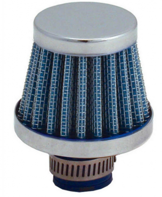

Is it possible to ditch the CCV hose and plug the hole on the intake and install a breather filter on the crankcase (like in the pic)?

some guys in this forums have used the above filter instead of the hose with very good results also did you check the box for an adapter to the breather ? good luck

Thanks for the reply!! I ended up getting a breather filter, like above, and attaching it to the stock CCV hose. It sits right next to the SB intake. I thought about putting the breather filter under the engine, but wasn't comfortable with it being so covered!!

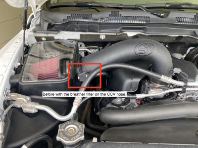

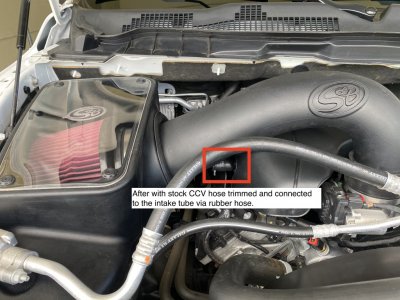

I decided to trim the stock CCV line with some PVC cutters. I trimmed the pipe short enough that I could place a some rubber tubing on it and connect the other end to the intake tube on the S&B. Engine cover is on and secure and the CCV hose is connected to the manifold AND the S&B intake.
I am attaching pics with the breather filter on the end of the CCV line and then another pic of the finished product with the CCV line connected to the S&B intake tube.
