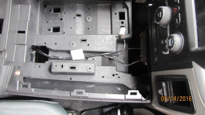

Is the media hub not in the top portion? Loose wire/bad connection that's being broken and restored when you wiggle it?
I wasn't a fan of it being in the console, so I rerouted the wiring under the center stack and my media hub now lives below the phone holder and I have USB wires coming up through there.

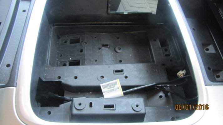

USB ports are directly connected to the radio
If you were going to upgrade the radio software, it is done through the USB Port
Under the bin/coffee cup holder, it is easy to see the wiring
Lift the rubber mats where you see the blue tape, it marks the 3 screws that holds the upper part of the console in place.
