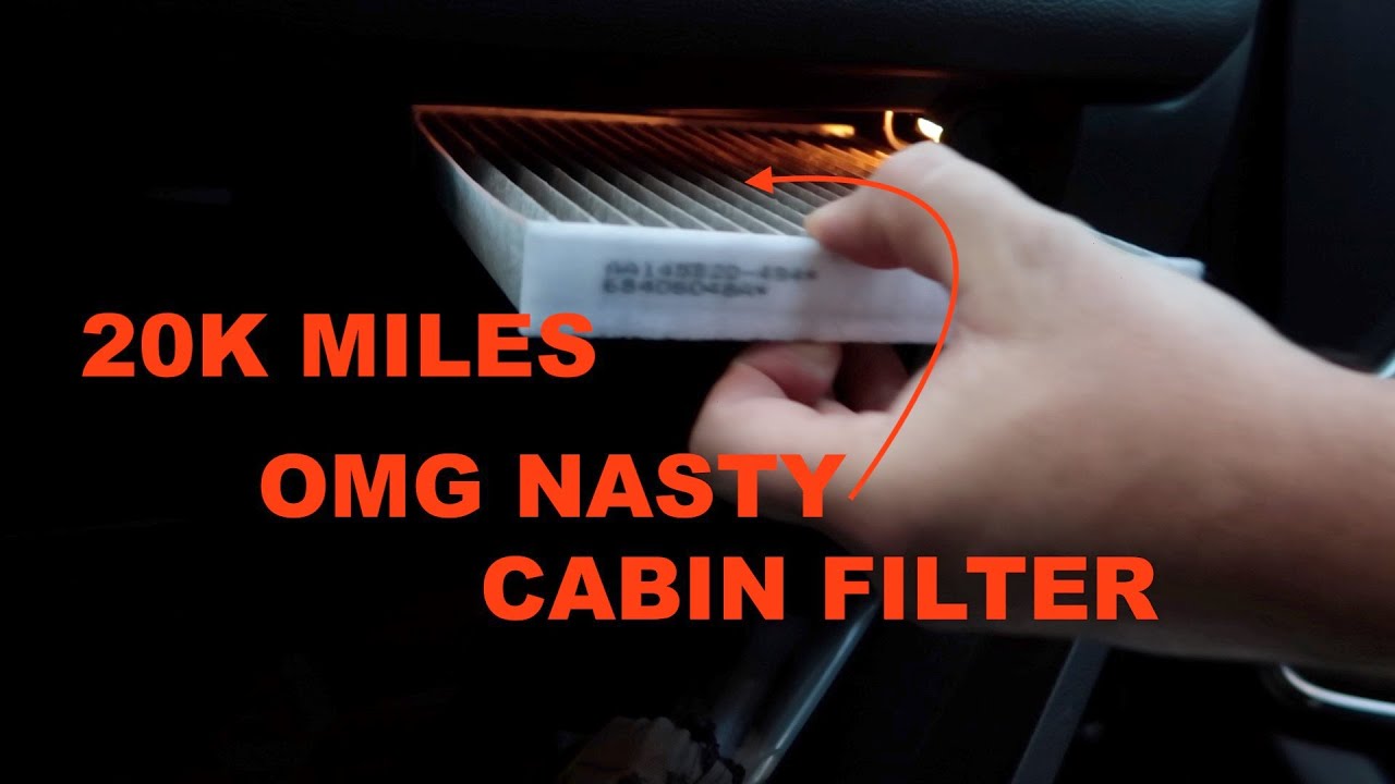

I have 16500 miles on mine and I have changed mine 3X. Each time it was pretty gross. It is my understanding that all cabin air is re-circulated all the time. This was first time at 5000 miles.

The 4th gen is easy. Even adding it in only takes like 10 minutes a new door and filter. Not sure on the 5th gen. I am sure its just as easy. Wifes old 19 Pacifica was just like the ram. Behind the glove box door. Let me see if I can find anything too.
Treburkulosis
Glorified Car Washer
Mar 21, 2016
7,520
12,543
Haslet, TX
@MADDOG his video is the same thing I found. So its the same as the 4th gen ram. This one has the filter # in the video.

I had the same experience at 11k. It seems to have more than just dust as well such as bits of things probably from leaves and other debris. Change it regularly at least every oil change or two.

I have a 2020. Very easy to change. Mine was super dirty at 24k even after dealer claimed they changed it at 20. Ill change every 10k with oil.
